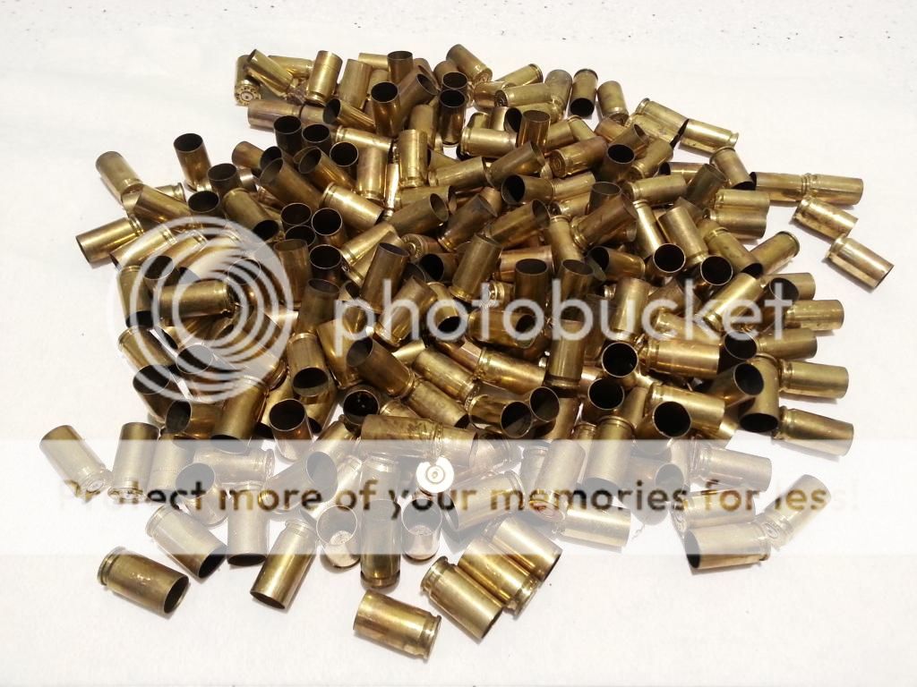

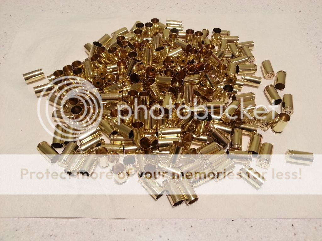

I think wet tumbling with stainless steel media is superior. See below for my before and after pics of some fired .45 ACP brass. It comes out looking brand new, and it will go through your resizing die a bit easier.
#4 ·
